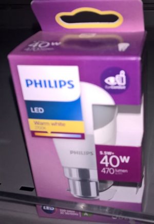

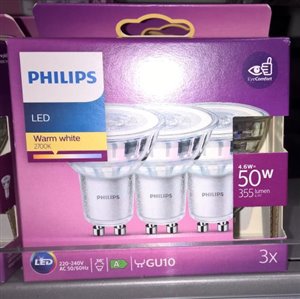

    Now look at the photos of two Philips packages I spotted in a local shop. One is a type clearly designed to replace a traditional tungsten lamp, and shows in large type the equivalent 40 W and in smaller type the lumen output, 470. This is actually quite generous; a 40 W coiled coil pearl lamp gives 390 lumens (BS 161). Look at the other picture, of the GU10 lamp pack. This claims 50 W equivalent, but the lumen output is actually lower at 355. Now halogen is supposed to be more efficient than plain tungsten so why the lower efficiency? I personally think that anyone expecting these to be as bright as a 50 W halogen GU10 is going to be disappointed. Explanation anyone?
