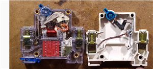

Big Clive on YouTube (not our Ancient Mariner) has released a video taking apart a fake Type C circuit breaker which is worth a look, but it is rather worrying what could be out there.
https://www.youtube.com/watch?v=2TJEzdqtXlQ
  • A different sort of 'bang test' is needed for these.
    OK, it is a bit lighter, but the con artists could easily fix that with some scrap metal.
    Do we need to add Xray to the tools of the EICR , as well as IR imaging ?
    Pity that the clear sided ones do not meet the glow wire test, or the containment during failure, they would be harder to fake.
    I wonder if they are now working on fake AFDDs that do not actually detect arcs ?
    If you ever want to test MCB function in the sense of is there any magnetic part at all, a car battery and jump  leads will get you a kA or two.

    I have seen that type of breaker before. An exact copy of the makers carboard box containing exact copies of the external  appearance. The only way to tell the difference is to open them up or put them on a digital scale. One of the manufacturers told me that on one of their plastic molds there was a tiny cosmetic imperfection that appeared on the genuine MCBs, the makers of the fake items had even copied this defect.

  • If you ever want to test MCB function in the sense of is there any magnetic part at all, a car battery and jump  leads will get you a kA or two.
    Mike
    Perhaps it's best to run a section of an an electric fire element in series to reduce the current a bit. I was told off when I admitted to using Wylex B6 M.C.B.s on my 12 Volt D.C. leisure battery boat electrics. A D.C. arc may well weld the contacts together or not be quenched by the arc extinguishers I was told.
