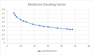

I'm looking at table 4B5 and am musing on interpolation of the de-rating values for differing numbers of cores from those tabulated.  I have an application I have been asked to look at with 16 loaded cores, and if I use the tabulated value for 14 loaded cores I can use the 30% rule, but if I use the value for 19 loaded cores I (just) can't.  At the factor of 19 loaded cores I am .005A the wrong side of less than 30%!
The challenge this gives me is that the OCPD is 10A rated, the design current is 2.826A, the 30% rule based on the multicore derating alone is 2.821A, and the fully de-rated capacity of the cores (allowing for a further group of the multicores in the installation) in the multicore cable cores is 6.11A.  If I can apply the 30% rule so no derating for the multicore cable then we are in the clear.  The cable is already installed and in all other respects calculates out fine.
The graph of derating factor vs number of cores isn't quite linear: 1711d4446663643ccb8ed6c700e2cdc2-huge-image-20210412170544-1.png
It nearly is in my region of interest though!  Does anyone have a formula for this calculation (if there is one?).

    To simplify the real question - if the factor for 14 loaded cores is 0.51 and the factor for 19 loaded cores is 0.45 then what should the factor for 16 loaded cores be?  An interpolation would give me 0.474.  Is that good enough?

  • jbrameld:
    Forget BED, he's tired. You need to interpolate.
    That said, do you want to do it linearly, geometrically, or exponentially? By my reckoning, linearly, the answer is 0.486 Ω - closer to 14 then 19, but it won't make any significant difference.
  • At least one cubic polynomial fit that matches the points on either side with an R of 0.996 would give you 0.4769,so things are perhaps a touch better than your simple linear interpolation.
    But calculations to this level of precision  are misleading as the raw data is not that good, and the differences will be lost in the long grass, the variation in ambient temperatures is likely to affect the answer more. Really between 0.47 and 0.48 is all that needs be said.
