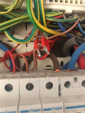

    Here's the original pic that was posted:
    323cc6d59029df9059aa9792ae4d17f7-original-172892401_2080129948795377_4707115388616175118_n.jpg
    A fuzzy picture, a tri-pod would have helped. The ends certainly do look like aluminium. No copper coloured centres showing. Don't bend 'em about too much, they are liable to snap.
    Z.
  • get a micrometer on it, and measure diameter in two directions and take average ~(compensates for ovality, to a degree), and then get an R1 reading over a long length, we can probably work out a rating from those measurements.
    apologies about the dates of the regs - I know the 1970 metric edition had some of the aluminium tables deleted so only the large sizes remained, I assumed that what came before included the smaller sizes - clearly not.
    Mike.

  • Still begs the question why verify the voltage drop on a fifty year old socket circuit with aluminium conductors?
    The next question will be “what was the permitted voltage drop at the time it was installed”? I presume the original circuit was designed to allow the connection of two 3 kilowatt loads at two separate sockets with there possibly being no more than half a dozen single sockets on the circuit. So the circuit may have been extended in an inappropriate manner, a bit of investigation will reveal if that’s so with additional sockets wired copper cables.
    Note it on the EICR and crack on with something else or consider running a new circuit for additional sockets if that is what is required.
