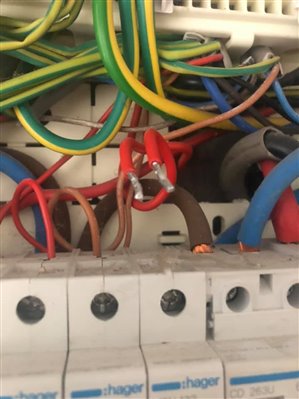

Hi,
Does anyone have a table of the ccc and VD of aluminium core T&E cable, please?
Thanks
F
  • I appreciate that this is not actually answering the question, but are you certain that the conductors are aluminium ?
    Tinned copper is is often mistaken for aluminium.
  • No, but if you look at 543 you will see that the value of k of a copper conductor is about 2/3 that of aluminium, so I think that you could use the tables for a copper conductor of 2/3 the value of the CSA of the aluminium one. You will not go far wrong.
    Bear in mind that a 35 mm² aluminium service cable goes with 25 mm² copper tails. 35 x 2/3 = 23 1/3 so not far out.

    fair point. It's not my job actually.
    Someone has asked elsewhere, with a picture of the ends of the cores, which certainly looks like alu all the way through.

  • Here's the original pic that was posted:
    323cc6d59029df9059aa9792ae4d17f7-original-172892401_2080129948795377_4707115388616175118_n.jpg
