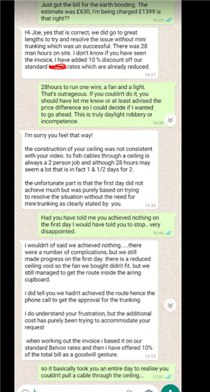

the final invoice came back as 28 hours work, £1399...  so that's 28 hours work to run about 6metres of earth bonding and replace the bathroom fan when the initial quote was a morning's work for £630.

    I asked them to avoid trunking if possible as it's really ugly. I made a small hole in the ceiling to see what was there and sent them a video to which they said "Perfect, we can work around that"
    So I naturally I assumed they knew what they were talking about and would be able to run the cable through the ceiling void...  But no.. after seemingly wasting an entire day trying to pull a cable through the ceiling i still ended up with mini-trunking in the bedrooms. here is the chat....
