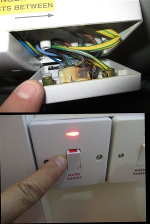

  • To avoid inappropriate separation or spreading of individual wires of fine wire conductors, suitable terminals shall be used or ends treated. (BS 7671-526.9.1)
    The photographs below show what happens when fine wire conductors are inadequately captured in the terminals of a 20-amp double pole switch.
    In some cases, it has taken more than five years for the effects to reach maturity.
    Demonstrating this, the photograph below has two types of wiring, with the same cross-sectional area installed into a 20-amp double pole switch.
    Twin and earth supply the switch and heat resistant flex is used as a means of final connection to a water heater.
    The T&E being single solid cores is happy to supply without failure or objection to the load.
    Capturing all the strands of a fine wire conductor in a terminal of this type is very difficult to achieve.
    Multiple outlets were discovered with the same fault, which could have been easily avoided.
    An indicator is cracking of the faceplate caused by excessive heat. Over time it will eventually turn brown.
    Not all terminals are loose!
