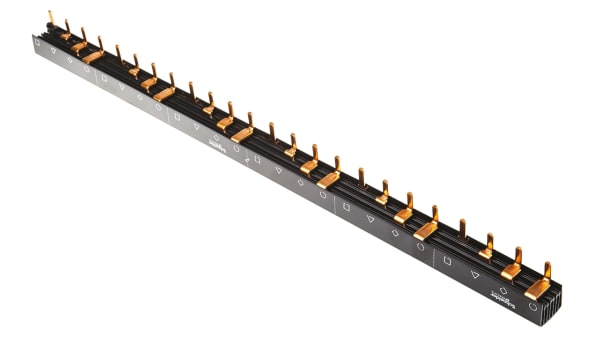

  • no -it isn't you need a box fitted with a proper 3 phase busbar, which is really  3 or 4 isolated busses in one block
    Each maker has (slightly incompatible) variations on the theme.

    3 phase boards for 3 phase loads have a 3 pattern L1 L2 L3  bus bar so every tooth is only connected to the ones multiples of 3 places along.
    . And just to catch you, L and N  (pitch of two) and 3 phase and neutral (pitch of 4 ) busbar is also manufactured but rarer.
    Ah I see! ?  Are these adjustable length wise like normal Busbar's?  Thanks for sharing.

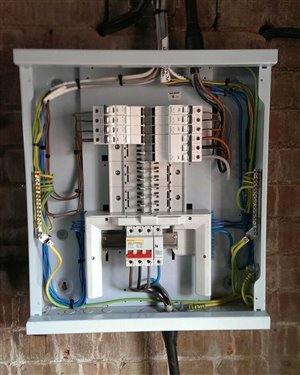

    Here is a pic of a typical "8 way 3 phase"  box from t'interet, to illustrate the key points  (Thanks to Coppice Electrical). Note that this has rather more covers removed than you'd expect if it was to be energised, but shows clearly the sort of thing you want to be asking about.
    Here the 3 phase MCB mounts on the right with the Brown black grey cores going out, and most of the  single phase stuff is on the left, but like the cable dressing, that is more about house style than any rules,  (some folk leave it so when you open the cover screws  it is fired off by the coiled up energy of the spaghetti inside, that  is not really the effect  to aim for .. ).
    Note that here the single phases are not RCBOs but MCB. If they were then both cores of the T and E would go to the breaker, and a blue neutral tail would go south from the RCBO to the N-Bar.
    This one is yet to be fitted with module blanks to cover  the unused  positions of the bus bar, and the cover over the incomer at the bottom.
    While the tape flags on the earth lugs are a tad unusual and  I'd have started filling from the bottom not the top, and I like pirahna nuts, but that is just  'house style' again  It is always possible to find something 'odd' with the work of others.
