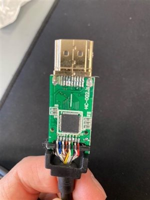

    It is definitely only a problem with the none passive leads. There is 4 ohm's resistance end to end straight out the bag measuring the outer of each connector (no continuity at all after they fail). This obviously get's plugged in to the PC and the monitor which are both then earthed via there power leads. The monitors are then screwed to "extraneous" steel shrouds that become exposed extensions of the earth via the monitor earth in the power lead... so I thought I might be on the something by taking them off the steel work but no, not the case.I have only removed one person's monitors though so unless something strange is happening cumulative across the other monitors.

    The symptom is therefore a large current passes through the HDMI screen (which is very thin foil) and it fuses. HDMI with a disconnected screen is not at all reliable, and the fault could damage the Earth referenced power on the cable to the electronics. Somewhere above I think you said there were 4 Ohms between the two ring Earths, which is excessive and cannot be right, I think you just found the 4 Ohms, the bad ring has no Earth to the Steelwork and a significant Earth fault somewhere too. You should find this with a full ring test, and Earth loop measurements, along with testing to find the intermittently faulty piece of equipment. These currents could be circulating Earth current from elsewhere, a clip-on Ammeter will help with that.

    Hi,
    Yes, someone previously mentioned about the 4 ohms being too high and I immediately realised i'd been a bit flippant about that reading as it is indeed high. I retested it but dropped the socket fronts off and got an improved reading of 1.5 ohms. Still high but maybe not alarm bell high!
    Here's a pic of one of the failed leads showing the chip and it's connections. No wires, including any shielding can bypass the chip by the looks of it...a9d1f22eadb2900519c44c5b22b66116-original-12.jpg

  • looking at the photo of that open lead, I think we have to imagine the chip 'doing the splits' between two things at not quite the same voltage,  both nominally earthed at the mains socket, but via quite a large loop of cables that gives some inductance and a time delay to the two paths and a fast spike may get round one way or the other such that there is a short duration large voltage difference at the chip.
    It is the sort of design that keeps EMC consultants in business, no series chokes, no clear marshalling of the screens, no overall screening can - lines from the chip direct to touchable pins, with no obvious series current limiting choke or ESD trapping - false economy all round..
    The two fixes are to either reduce the area of the pick up loop, (shorter fatter leads or an over braid on the lead between PC and monitor), and/or  better to stop the spikes getting in there  in the first place - which may or may not be mains borne - the swap-over test will tell..
