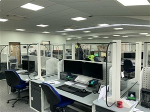

Hi,
I'm new to the Forum but i'll try and explain this as best I can as it's a strange one!.. Sorry it's a long one!
The issue -
For several weeks now, there have been reports of multiple Monitors intermittently switching off and on again across 5 or 6 different PC users in an office of 20 PC users. Sometimes as little as twice a day but up to as often as15 times a day Apparently, this has led to multiple monitor leads no longer working and being replaced but the issue still remains.
The system -
Sub DB fed from Main DB on a TNCS system (The office is part of a larger factory / workshop set up). The circuit in question is a 32A Ring with a 30mA RCD up front, feeding 24 twin sockets in 4.0mm2 T+E. It is dedicated to office use only. Only 1 of the 2 earth connection points have been used on each socket outlet and no extra earth has been ran alongside it, so simply a ring main earth and that's it. It is a fairly new installation but the equipment has all been used before as the personnel have just moved all their stuff from an old office into a new one. There is an identical ring circuit feeding the other side of the room with the same set up but with no issues with their monitors reported (same monitors and fed from the same Board).
For the most part, monitors and PC's are plugged directly into the wall sockets but there are a few stations that are fed from 4 way extension leads. Problems are occurring on both set ups.
What's been tried / observed already -
Socket fronts dropped off, no N/E reversals and all connections tight. R1R2 = 0.05 ohms and insulation resistance test at the board = >999 Mohms so no issues across any combination of conductors.
Mis-leading -
I had a cheap and cheerful meter connected via Bluetooth that was sampling and logging every second, that picked up frequency spikes of up to 350Hz! I am now convinced that this is a banana skin and that the meter may have been suffering some communication interference (maybe caused by the same fault dropping the monitors out?!) as I later connected an Oscilloscope which did not show any fluctuation on 50 Hz. Thought i'd mention though just in case!
What the scope did pick up though, was a voltage on the exposed metal casing at the bottom of the monitor at the rear (Where the DVI ports etc are) that spiked whenever the monitor was turned off via the fault.
Here's where it gets weird.... The PC users, prior to my involvement had set up a 100w lamp (Bayonet type) to see if it would flicker when the monitors turned off (which is doesn't) but in actual fact, when you turn the lamp on and off, it would throw huge spikes onto this metal casing at the back of the monitor! I measured up to 100V on the scope! It would also turn the monitor OFF/ON. The lamp has no earth connection as it is all plastic housing.
When I plugged the lamp into the sockets on the other side of the room (Separate ring circuit) it did make a slight reading on the scope when probing the same part of somebody else's monitor but nothing like the amplitude I was getting on the problem circuit. More like 5V rather than 100V and no monitor issues either.
I can only assume that the RCD isn't tripping because it is such a fast spike! However that does surprise me that it would still damage a lead!?
I have turned off some of the Aircon unit circuits for as long as i've been able to as I wondered if a faulty inverter may be throwing something down the earth but it didn't seem to reduce the flickering.
So yeah.... Help!

    Right, well you have been a busy bee. Thanks for all that hard work. Digital persist is jolly useful on a scope isn't it?
    What follows may be complete hogwash, it is as they say 'your party'. However, here is how it feels to me, having read it.
    I think we should assume for now probably only really borking leads with electronics in, and the IT folk who had hold of it before you are either not remembering it right when they tell you, or they were special HDMI leads that had frame rate converters in or something, but in any case were not simple passive.
    Display port - ah yes a right pain in the interface being 3V logic, when DVI and HDMI are 5V. Expensive if the level shifters are omitted in the cheap far eastern model
    I had not clocked immediately that the clean and dirty rings were 2 phases on the same DB, so two lives and a common neutral.
    That opens the door to a fun test. IF they can be swapped at the breaker, does the problem also swap to the other side of the room, or safer, if moved both to the clean phase, does the problem go away ?
    I.e. have you really got one dirty phase coming into the board? I suspect you have something like that, but it is hard to prove. If the sub-main feeding the DB is SWA or waveform, then it forms a kind of coax transmission line, so spikes can be conducted in from quite a distance away without much attenuation.
    The short duration transients may be partly radiated - faster then about a microsecond risetime, (well for wiring of tens of metres long) and it is often as easy  or easier for the energy to get off the wire and back on again further down in a radio and antennas or even a loosely guided wave sort of way rather than in a purely conducted way.
    I suspect your remote light switch may be re-creating a version of  the famous experiment of Heinrich Herz    but with the scope serving as a rather more sensitive detector than Herz's original spark gap.
    So, what to do? Well first stop plugging in and flashing lights ;-)
    More seriously, it seems there are fast spikes coming in on the second phase, so some sort of filtering at the DB may be worth installing, of the kind that puts quite some capacitance from L to E and N to E, to absorb any fast rising edges inbound, Verify that the  N voltage is not moving relative to the lives, by looking at the NE waveform on the scope at the DB, or as near as you dare get to it,  You may care to beef up the earthing. Threading some ferrite on the inbound cables will have no ill effect on the 50Hz, but will raise the series impedance to provide opposition to microsecond scale stuff. (example)
    There is one other possibility to be eliminated - and that is one of the loads on the dirty ring is acting as the impulse generator, perhaps with partial 'crackly'  break down of a varistor or internal filter capacitance inside the PSU in one PC or the other when it warms up. Or a scratchy current carrying contact in a plug, socket or mains lead. This would be the suspect if the swap phase test brings the problem with it..
    I assume you would have mentioned other details like metal suspended ceilings or floors, but if there are then these are possible re-radiators.
    Mike.
    Edit do not be upset by the phase inversion - the scope will trigger on both positive and negative edges, and a sine wave with some zero-crossing distortion that includes an occasional 'twitch' or reversal of direction may cause it to trigger on a short up ring during a down edge, so it appears to fire on  the wrong edge occasionally, and the persist on the scope makes it look really weird.
    Traces with fuzz riding on them like the chairs on a ski-lift are hard for the scope to get a grip on, even a modern digital one.
