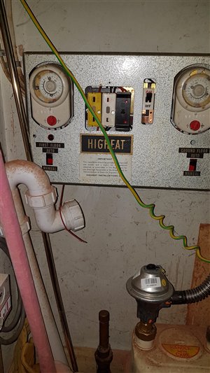

Hi,
I need verification that it is ok to keep old style Wylex rewireable fuse boards to pass the EICR. Initially the electrician said this was ok providing they have a cover for the fuses. However he has now changed his mind and saying they need to be replaced with a new consumer unit. Some of the homes do not have a cover on the fuse board and others have had the cover taken off so plug in mcb's can be accomodated. Is this still ok?

  • If fitted with fuses and the cover is missing then C2 and needs replacing.
    Or just find a replacement cover? (e.g. https://www.ebay.co.uk/itm/154416681465 ) - £15 when you just want the cover might seem steep but it's got to be attractive compared with the cost of a complete CU change.
