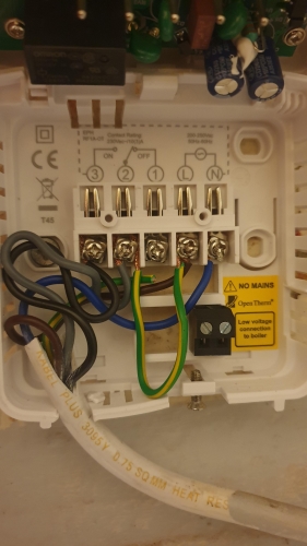

A small theatre that I look after called me today as they have had a heating chap in to look at a problem with heating in the bar area.  It's part of a 3-zone system with motorised valves.
He declared the wireless thermostat faulty and proceeded to replace it, whereupon the heating in one of the other zones sprang into life, and the broken one didn't. He realised they had replaced the wrong receiver unit, and then persuaded the financial controller that we should probably replace the other one as well as that would likely fail soon anyway.
So now 2 new wireless stats, and the original zone is still not working, so they decide the motorised valve is faulty and replace that - hurraah - the zone now works.....but the zones with the new stats are not respecting the programmer status, and come on based on the stat setting even if the zone is off on the controller.  It's clearly getting towards knocking off time and they think there is some poorly understood problem deep in the system wiring that they are not sure how to figure out - so I get the phone call from the financial controller asking if I can a) take a look and b) arrange to meet the heating chap to see if we can sort it together.
I popped in and this is what I found: in the new stat bases.

  • Only one screw holding it onto the wall, anything else?
  • How about an incorrect link between the line and the common (thus bypassing the switched live from the programmer), and using green/yellow cabling for a line link?
    Jason.
  • also a cpc or unused g/y wire just truncacted and dangling next to live terminals
  • I had spotted the grey.
    You can add the missing cable restraint to the list, though there is plenty of slack on the conductors in case they get a tug.
