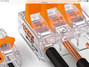

    (In this instance, I'd use a Wagobox with lever connectors.)

  • It needs the big red Wago connectors not the lever connectors, if you are using Wago.

  • Sparkingchip:
    ? Wago do 6mm2 221 lever connectors rated at 41A. Also the standard 4mm2 221 lever connectors are rated to 32A unless they're derated for e.g. a MF setting.
  • wallywombat:
    Sparkingchip:
    Oh! The joys of working with Wago connectors.
    I stood on the Wago Box stand at the Coventry Elex show discussing Wago connectors and maintenance free connections, the ratings you see on the connectors, the cardboard boxes the connectors are delivered in and specification sheets vary.
