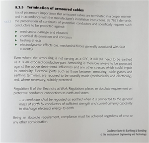

  • It’s easy to find guidance telling electricians to earth the armour of SWA cables, such as this:
    Providing automatic disconnection of supply (ADS)
    Regardless of whether the armouring of the cable serves as a protective conductor, or not, it should always be effectively earthed to ensure the requirements of ADS are met. Should the armouring not be effectively earthed and a fault develops due, for example, to mechanical damage of a line conductor incorporated in the cable, the condition may leave the armouring attaining line voltage and pose a danger to persons in the vicinity of the installation or using the installation.
    https://www.voltimum.co.uk/articles/guide-installing-steel-wired-armoured
    Can anyone post a link to what seems to be an authoritative article saying that it’s not required? There’s plenty of “how to do it” videos on Youtube in which electricians say it’s not required, but I don’t count consider those authoritative.

    On Friday, I had a chat with the technical manager of a leading cable manufacturer. He stated that best practice dictates that the steel wire (not used as a cpc) should be earthed at least one end, but he did not have a problem with unearthed steel wire as long as the installation complied with BS7671.
    So, back to my original post… applying BS7671, and commonsense, the installation is compliant.
  • Just remember that in the smaller sizes of SWA the bedding is an extruded plastic that looks like and gives the impression of being supplementary insulation between the basic insulation on the conductors and the steel armour.
    But, on the larger sizes of SWA, generally 25 mm and above, the bedding is plastic string similar to the plastic garden twine I have just used to tie my tomato plants to support canes in my greenhouse, there is absolutely no way that this plastic string can be considered as supplementary insulation.
    So as far as I am concerned SWA has single insulated conductors within metal containment and that metal containment needs to be earthed, which isn’t difficult.
    On the odd occasion I only earth one end of the armour I use heat shrink or as tape to ensure the end of the armour cannot be touched from within the enclosure on the end that isn’t earthed to avoid there being two accessible earthing systems within the same enclosure.
    To sum up, I’ll stick with guidance from the authors of the IET GN, incidentally I did read the page in the GN that acknowledges some of the authors and contributors ?
  • Former Community Member
    0 Former Community Member
    Schip - Your contribution has been helpful. I would follow your example when installing myself and advise others to do the same, but the G in GN is for guidance. I need to quote Regulations and keep in mind the end of Chapter 12 when writing reports that could be used in a court of law.
  • So as far as I am concerned SWA has single insulated conductors within metal containment and that metal containment needs to be earthed
    But in this particular case, unlike most steel conduit, trunking etc., the "metal containment" isn't exposed - it's protected by a plastic sheath - rather like the sheath that covers basic insulation on T&E cables. If it's not an exposed-conductive-part how can you insist it must be earthed?
    Rather like the debate about insulated & sheathed cables run inside unearthed steel conduit (for purely mechanical protection) - (a common practice on the continent) - I think it's accepted that that's OK since we already have the equivalent of double/reinforced insulation between the conductor and the inside of the conduit. This case only differs in the order of the metallic and insulating sheath layers.
