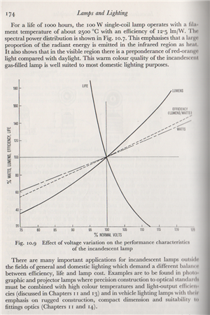

    Have you got the same info for a "coiled coil" filament lamp please Mike.
    Z.
  • not as another  graph, the indication in the text is that it is substantially the same, with the efficiency curve moved up a bit, so less watts for the same lumens,but the same trends.
    I;d expect quartz halogen to have a slightly different slope on the life curve however, as the filament evaporates and self repairs to a degree.
