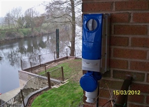

  • Around nine years ago I installed a socket on the back wall of a house for a hot tub.
    It turned into a one off job, the hot tub needed a 49 amp supply, it was going right by a river and was at risk from flooding so the tub needed to be able to be moved quickly, also there is the possibility the socket could be used to supply a boat, so I ended up installing a 63-amp interlocking socket and recording the deviation on the certificate.
    Unfortunately when there was a flood the tub wasn’t moved and the last time I saw the tub it was tied to a tree and bobbing up and down in the river. Best laid plans and all that.
