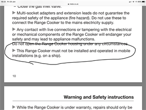

  • d5285b09446b632797c532b1b860e798-original-68c016a9-f683-4da4-ab85-80fbabf1839a.png
    Typical range cooker installation instructions

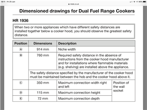

    115 mm height to top of socket outlet is likely to breach 553.1.5.
    Regards
    BOD
    Regards
    BOD

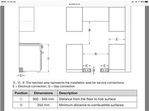

    Anywhere else and the cooker may not fit back to the wall.

    Surely Sir  did not intend to summon the regulations allowing use of a shaver socket ?, but perhaps had in mind
    553.1.6
    A socket-outlet on a wall or similar structure shall be mounted at a height above the floor or any
    working surface to minimize the risk of mechanical damage to the socket-outlet or to an associated plug and its flexible cable which might be caused during insertion, use or withdrawal of the plug.
    Or
    553.1. 7
    Where mobile equipment is likely to be used, provision shall be made so that the equipment can be fed from an adjacent and conveniently accessible socket-outlet, taking account of the length of flexible cable normally fitted to portable appliances and luminaires.
    I'd not be worrying about either of those to be honest, rather what fits behind or beside the cooker.
    It won't be anything like as big as the one illustrated above unless this is in a 7,5 tonne lorry….
