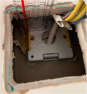

    Thank you all for these amazing insights. After some digestion and further inspection of the current back box. Here is my update and I think is on the brighter side.
    The back box is type “dry lining” mounted in a stud wall. After removing the back box, there is about 55 mm before interfering with the back box on the other side of the wall. So I think all I need to do is buy and fit a "1 gang, dry lining, 45mm back box
    In term of the current wiring, there is 2 wire in the common, 1 wire in the other side. Seems like "loop at switch" to me? And all earth and neutral are connected.

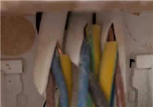

    PS: upon inspection, I noticed insulation of the earth wire were cut or maybe just sleeved in? Want to check if this is standard practice?
  • Cutting off earths is not good practice, but sadly far from unknown at the shallow end of the profession…
    The small wagos are very good if you get the right ones. the lever ones are best for folk who may change their minds.
    Personally I like the wago 221s,  and have a couple that I keep for testing as well.
    I think  a 45mm box is the deepest you will commonly find..
    Mike.
    The workmanship is a little rough, but everything looks OK. I think that you have the right plan of action.
  • PS: upon inspection, I noticed insulation of the earth wire were cut or maybe just sleeved in? Want to check if this is standard practice?
    Yes, that's normal. Flat “T&E” cables have a bare earth wire - which then needs to be sleeved with green/yellow sleeving where it is exposed.

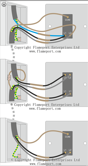

    I noticed some light switches are 2-way or 3-way. I'm planning to use one wired switch, with the rest replaced by some battery power switches. If the wiring is like the image below (although I have not checked), would it be legal for me to terminate the live and neutral wire at the topmost box? Such the live and neutral wires to the latter two junction boxes will be abandoned. I assume it would be reasonable to leave the earth connected to other back boxes?
    3-way switch (without neutral wire?)
    I assume I need some labelling to indicate the abandoned neutral and live wires, are there any conversions? I will put a blank plate on the latter two back boxes with abandoned wires, and just glue the battery-power switch on top, so you can't tell from a distance.
    Based on 3.13 of the Part P, I need somehow get the “non-notifiable work” inspected and tested. What is the most economic way of achieving it? (I will of course keep a record of all the modifications I made so it can be referenced later)
