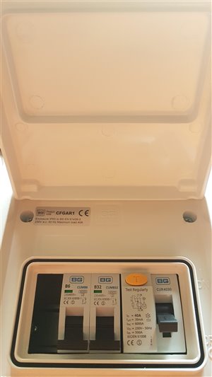

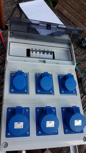

    Are you talking about the temporary installation distribution boards that you are more used to?
    Regards distribution boards versus consumer units, the Wiring Regulations doesn't differentiate between them and they comply with the same standards.
  • Not particularly Andy, the one you show is fully exposure proof but the normal metal types are very good. Why don't you show the IP67 ones? I assure you I am fully “used” to all kinds of switchgear.
  • The BG garage units are IP65 the lid clamps shut onto the rubber seal and there's a rubber seal to bed the front cover onto the pan.
