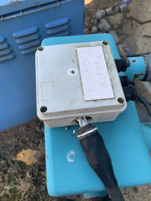

Single cores outside enclosure
Are Single cores outside enclosure classed as a C2 for a EICR?

  • 8e1b3af4fc7544d13743723b47d03238-huge-020b610a-a595-45a0-a34b-cdb4e6b2b93a.jpg
    C2?

    External influences such as damage by rodents can lead to such a situation. Far more likely to go unaddressed where it can't be seen. Shouldn't be “C3” because this can be left forever without correction. “Out of sight, out of mind". Potentially dangerous - C2.

    C2?
    Clearly mechanical protection is needed here, otherwise SWA wouldn't have been chosen. However, is it immediately dangerous (the criteria for C1)?
    Well, in this case, it could be if there's water (particularly salty water) present …
    As DZ alluded to in an earlier post, it's OK having “coding rules” but sometimes the particular circumstances do need to be taken into account.
    For example, if the above picture were outdoors in a position accessible to children in a primary school within a few hundred yards of the coast, I'm sure we might be seriously thinking about a more stringent coding. But C2 leads to unsatisfactory anyway …

    C2?
    Yes, but let's think about it.
    What is the gland made of? It does not look like brass. If the sheath is the CPC, it has been lost so that's C2 plain and simple.
    The risk of conductors becoming detached is high. If that is on the load side of the box, and everything came out, no problem; but if one of them is the CPC, that's back to C2. If the conductors are TPN, the consequences of one becoming detached depends upon what is at the other end.

    MrJack96:
    C2?
    There doesn't look to be a protective conductor connected to the gland, although that in itself may or may not be an issue - it might be earthed at the other end.
    Is it a mains cable or a control cable operating PELV (although the latter would still require an earthed armour if the cable is buried).

  • I believe it’s a control cable operating solenoids. Interesting discussion alot of factors to consider. I doubt there would be a presence of salty water and being industrial mostly operational staff on sites so from what you’re saying a C2 would be relevant. However if full of rain water would this then become a C1?
  • Does the code matter? Would anybody seriously want to see it left like that? ?
