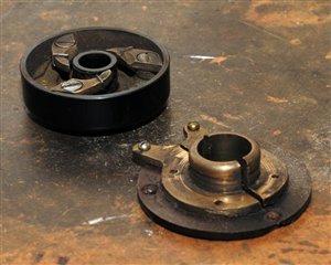

    Here are the two parts of the switch. The depth of field is poor, but I think that you can see the wear on the fixed side of the switch. The range of travel of the 3 pawls (or at least one of them) is limited and I think that it no longer makes contact adequately.
    The switch connects (and disconnects) the starting coil. No capacitor.
    The motor powers a Tiplap lathe tool grinder - Google it to find out more.
  • Looks as if you could file a touch off the back of the weighted pawl to allow it to swing in a bit further and with a bit of brasso and old sock rubbing perhaps  get another 50 years out of it (!)
    Maybe some wet and dry to take out the grooving.. It may not have been pulling clear at full speed as it should. A lamp on the starter winding will tell you that.
    Some designs have pinhole to allow a wire, or thread  or similar to hold the sprung pawls out of the way until it is assembled, and then this has to be withdrawn and they click into contact position. Cannot see that in the pic here, but if assembly seems impossible that is a clue to to look for.
    Of course for each start it only gets about five seconds of rubbing before pulling clear so the starter contacts and winding are not heavily worked electrically speaking.
    M.

    The curved lip to the fixed contact allows the pawls to slip over it.
    What is bizarre is that there seems to be no way of disassembling the motor without damaging the paxolin plate because the force required to pull off the tail bearing is greater than it can withstand. By contrast assembly will be no problem - the bearing will be fitted to the case, the switch will go over that, and then the armature may be fitted.
    Better get it right first time!
  • seems odd. Is the bearing a bronze bush knock-on or a ball or roller race ? sometimes things would be put on warm. I have used offcuts of glass fibre PCB material with the copper all etched to clear on both sides as a paxolin/tufnol substitute in cases needing a bit more strength.  While it is a bit odd the online PCB places are quite happy to do PCB cut outs in funny shapes without any copper.just needs to be drawn as a gerber outline.
