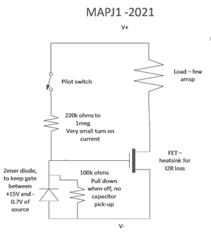

  • Cannot directly help but you may be able to switch a pilot signal to operate a power transistor in a box, or even a relay, but they have a similar contact derating problem.
    (there are many possibles, but just  an example. would need a turn on resistor and Zener to protect the gate-source junction from blow-out.)
    A high voltage FET as a switch/solid state relay for DC
    What is the load current and is the polarity fixed ?
    I'd only use that for cases where if the transistor failed and it came on by accident it was not the end of the world.
    The arc damage is a function of the current flowing and the breaking time the old DC switches had a very fast contact separation,
    If you have both supply poles available you can even do the electronic equivalent of the big circuit breakers and have “load contacts” and “breaking contacts”  where the breaking contacts are in parallel and only carry the load when the switch proper is opening, so no volts across it at the moment of opening.

  • Dont really want anything other than a switch because the supply is AC from public mains most of the time, changing over to DC from a battery in the event of a power cut.
    Load is only a fraction of an amp.
    Emergency lighting for a very large house.
  • Ah OK, ignore the above then. Tumbler switch of the old fashioned kind - sadly rare
