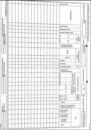

    seeing as you must be familiar with EICR - I have another query. Does the back page of the document need to be filled in? The one that is allocated to circuit designation? As on the EICR it is completely blank.

    If you mean the generic schedule of test results, that is essential. It is, arguably, the most important part. No schedule = no EICR.

    I have attached an image of the back page of the EICR document as well as the file for the whole EICR: just to confirm you are saying that due to this being completely blank the EICR is void?

  • well that is very disappointing. Unless there is another sheet a bit  like that that came separate to  the report but filled out ?
    This is supposed to be the bit that describes the installation. As a general rule there should be at least one line per fuse or circuit breaker in the consumer unit, and perhaps a few additional notes if there are unexpected extras like the landing light on a different circuit to the rest of the upstairs lights - it happens ?.
    You can then deduce that the lights are on fuse no 3 or whatever, the type of cable used, and what the earth test results and insulation readings were.
    Without that trying to deduce what is there without actually taking it all to bits is a bit of a non-starter.
    Also surprised this flat has no bath or shower, as all NA in the last section …
    Mike.

    It isn't so much void as incomplete.
    The paperwork seems to be a bit of a mongrel - it is not the current model form or the one before it. As Mike says, presumably there is a bathroom.
    There are other errors: e.g. Item 4.20 - I doubt that SPD is fitted. There seems to be a generator. PFC = 0.2 kA on page 3 but 1.07 kA on page 8.

  • Although it does say it is a visual report, much of the circuit chart could have been easily completed. If he actually visited the property, it could only have been for a few minutes, as others have said, he never discovered the bathroom.

  • Alan Capon:
    Although it does say it is a visual report …
    I don't think that that will do.
    Chapter 65 refers to inspection and testing (my emphasis), but more importantly, R.3 of the ESSPRS Regulations 2020 requires that the installation be inspected and tested.
    I might add that for a small domestic installation, a 20% sample is not adequate.
