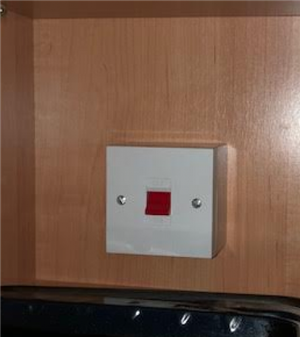

We need to replace our double oven. For the last 20 years, a 30A trip fuse has provided power to a dual wall socket (kettle 2.2kw, microwave 1.29kw) and the oven with a 5.1kw max rated power consumption. I've discovered this by tripping the 30A fuses in the fuse box to see which appliances were still live.
It appears that when the kitchen was fitted (20 years ago), the original standalone cooker on/off master switch was converted to a dual wall socket and the then a spur used for the double oven.
According to my maths this is a total of 35.79A @ 240v which is more than 30A, although I'm guessing the times all three appliances have been on at the same time would be infrequent.

    I omitted to say that there is a isolation switch for the current double oven. The original standalone cooker switch has been converted to a double socket and a spur used to feed the double oven but there is also an isolation switch on the spur. I missed that point in my earlier posts. I think this would be an “all-pole” or “double pole / double throw" type switch but I cannot tell without removing the faceplate screws and inspecting it.
