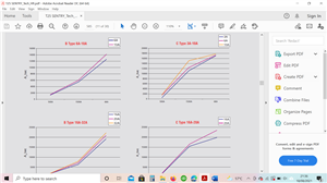

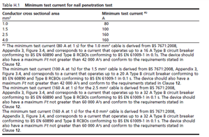

This is the first time I've used BS8436 cable and primarily it is being used to get around the cable not being in permitted zones/at depth within the floor and walls. I've read the guidance with regard to using type B class 3 MCB's at a fault current <5kA which is what will be happening in this installation. I have noticed some suppliers give a maximum energy let through for the protective device (42000A2S) but annoyingly the particular supplier (Atom) that make the cable I have been given do not - I've asked them but am not holding my breath. Do you know whether this maximum energy let through is built into the product standard by any chance. The energy let through of the 3A type B MCB (and probably the 16A type B at the origin of the circuit) is almost certainly going to be far below 42000A2S within an installation with a PEFC <3kA - do I need to look any further into this or is the use of type B MCB's just a ‘given’ with this type of cable.

    Regarding the PFC thing- when I come across reduced size ring final CPC's I do check the energy let through of the CPD's at onsite measured PEFC and compare this to the K2S2 of the CPC in an attempt to prove compliance. I also do this when I encounter higher pfc's on installations with T&E present. Would you consider that a redundant exercise given the discussed feasibility of network change?
    The same I suppose would apply to your measured earth fault loop readings on circuits if they were a bit on the edge. I've always based it on how it tests on the day particularly with existing installations. I've seen the design guide recommends designing for worst case scenarios from the network. i.e. a 16kA pfc and for example a 0.8 ohm ze for a tns system. In the real world this just isn't going to be practical though is it - and T&E would never be seen again - even in a domestic environment as >3kA some of the cpc sizes get a bit skinny (as table b7 in the onsite guide recognises).
    Going back to the type c/rcbo thing - it seems to be a widely held misconception:
    Seriously though. Thanks so much to you both for the discussion. It's great to be able to bounce these things off someone!
