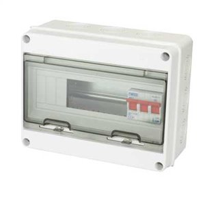

  • Would you be happy with this solution for a hot tub?
