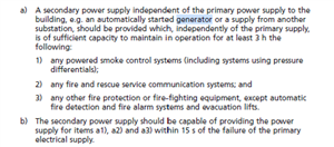

Does anyone know if BS9999 poses a limit in the number of seconds between a power failure and the generator taking full load on?

    I thought it would be 10 sec but 15 works fine as well
