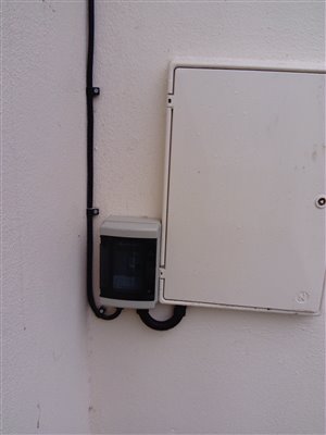

Anything inherently wrong with installing consumer units outside?
IP rated (IP65/66).
The plan is to install henley blocks into the exterior meter cupboard, and a supply taken to an IP rated lockable enclosure on the wall directly below the cupboard to supply an outbuilding.
How does the sway in temperature impact MCB and RCD functionality? They all seem to be rated to sub zero temperatures and in excess of 40 degrees.
Anyone with any extensive experience doing this?
Thanks.

    I was really referring to a plastic consumer unit like the attached.
    As this will go on an outside wall, under tbe meter/DNO box, I don’t think there is a requirement for it to be made of metal.
    It can’t go inside of the DNO enclosure, so under it on the outside wall itself seems like a logical solution?

    Customer has their main fuse and meter in a DNO cupboard that is sunk into an external wall.
    The new setup can’t go inside for obvious reasons, but a plastic IP CU on the wall, under this DNO cupboard, I think will be ok?
    Like this found on Google:
    https://www.cef.co.uk/catalogue/products/1925117-8-way-insulated-ip55-enclosure?gclid=Cj0KCQjw1dGJBhD4ARIsANb6Odm7A6ezBXk7qSsidc1Ix3AtG4tMdfIrv4pYev1q9tjEqlvrO6djd_8aAjPwEALw_wcB&gclsrc=aw.ds
