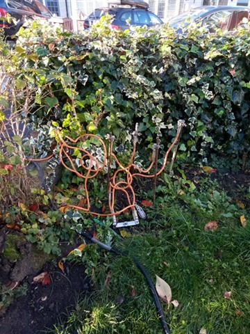

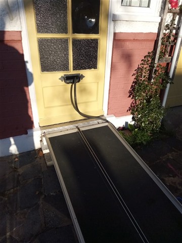

  • That letterbox  is indeed a class act. Had they said something to upset the team I wonder ? (shades of the ununlucky Mr Meldrew). Traditional way in would  be a fanlight window and if needed a couple of bits of chipboard one inside one outside screwed together to form a clamp to stop the draught.  I imagine there is no reg broken, apart from the one about good practice, but the earth rods look a bit shallow and rather close to each other to get the low ze  benefit of parallel connections.
    Mike
  • Thanks Mike... I just laughed, when I noticed this.
    regards...
  • Cables through letterboxes are in my experience a common approach in this situation. Almost every home has one so it is a simple and quick way of restoring power.
    Drilling holes takes longer and risks damage.
  • https://www.youtube.com/watch?v=lNEXWITxkmg
    May be of interest, cables through letterboxes for some customers. Others restored by temporary connection of generators into the street mains.
  • Fair enough... thing was I haven't seen that done before. At least they had power!
    regards...
  • Have done it that way in the past when I worked for a DNO even used 6.0mm t&e.

  • The usual is an earth electrode, although the System Neutral usually makes a better alternative. The temporary supply cable is usually terminated on a cutout mounted on a meter board. We would normally cut a slot in a meter box door, then mount the temp cutout next to the usual one - this is why we don't want customer equipment in the meter box!
    With a cutout inside, "through the letterbox" is the best and easiest option, and would be first choice. With a "temporary" between two houses, it is not unknown to have a temporary cutout on both ends of the cable, go out one letterbox and back in through next doors.
