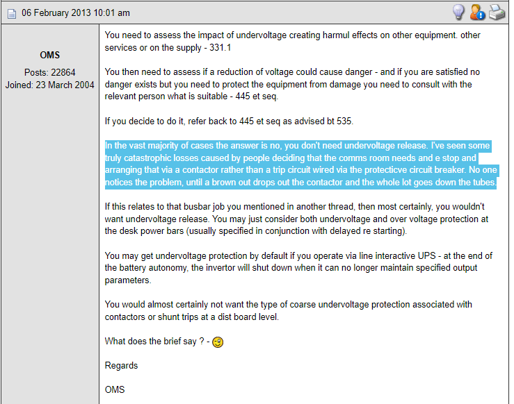

Referring to the old forum thread, https://www2.theiet.org/forums/forum/messageview.cfm?catid=205&threadid=50718
Hi OMS, can you please explain about the blue highlighted part below here.
