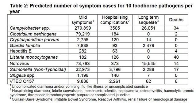

  • Not sure why it is scary-  you are statistically much more likely to be given food poisoning at someone else's house than be electrocuted, and nearly an order of magnitude more likely to die from it.
    (around 2.4 million estimated UK cases of foodborne illness occur each year)  or if you prefer only the numbers at the end of the table, a  hundred or so die each year. Of those that need medical treatment the approx breakdown is as follows.
    (source PDF page 26 of this food standards agency report )
    Compare with electrocution from this link
    deaths where the underlying cause was exposure to electric current; by sex and five year age group, England, 2001 to 2017
    The ONS...
    Of course only those where the W location code ends in '0' occurred at home and may be influenced by part P. And most are at places of trade or service (codes end in '5') or industrial/construction ( codes end in '6').
    Domestic electrocutions are less than ten a year and predominantly male. Tellingly the figures from 2001-2004  (pre part P and all that) are not much different, despite both part P and the adoption of RCDs in all sorts of places where there were none before.
    So, if we scrapped part P and put all the saved money into food hygiene education, would we as a society be more or less safe ?
