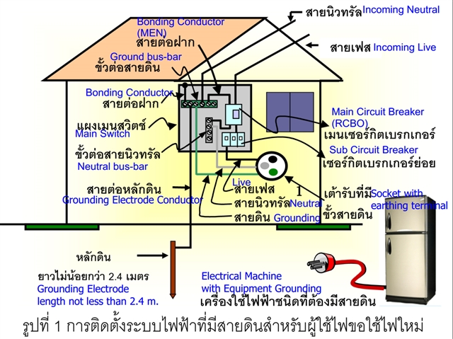

Thailand is nominally 220V (Phase-Neutral) 50Hz, supplied as 3-phase 4-wire TNC-S with a local earth rod, neutral earthed at every 3rd pole, N-E link in the consumer unit. Supply is invariably aerials with the "weatherproof" meter on the power pole outside your gate.

    From the local equivalent of the "On Site Guide" (my translations).
