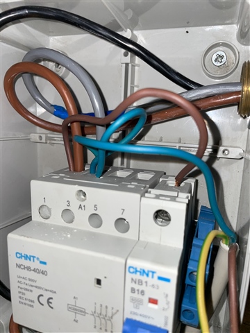

Hi there. I was called to an oven fault yesterday and found the circuit incorporated a contactor. I had voltage up to contactor but it would not energise and had no voltage leaving to the oven.
I changed the contactor thinking it would sort the problem but it made no difference.
In the top of the contactor where the supply sits there’s an mcb sitting in parallel which appears to feed a fire suppression pump mounted in the extractor hood. My thoughts were that perhaps this could be the issue but I don’t know enough about the suppression unit to test it. Anyway I would have still thought the contactor would pick regardless?
Any ideas would be gratefully received.
cheers
Ben

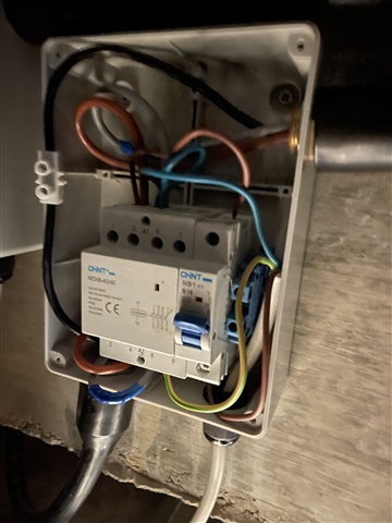

  • Have you got a photo of the bottom of the contactor?
    it looks like the mcb is for the control circuit and is fed from the live side of the contactor so you would need to follow the wire out of the bottom of the mcb which I would expect to go to whatever triggers the contactor and then make its way back to terminal A2.
  • Thanks for your reply. The wire from the bottom of mcb goes in to the right hand flex and goes to a JB in the cooker hood where it’s connected to a fire suppression device.
    In the JB I did notice that a neutral from one cable was connected to an earth from the other cable. I checked the other hood for the oven that’s working fine and the wiring is exactly the same.
    The fire suppression flex goes into what looks like a pump or canister. As I’m writing this I remember it being taped up where the cable enters and a bit of a kink in it. I didn’t know much about the device so I didn’t play with it.
    Thanks again.
  • Thanks for posting the photo, that seems to confirm suspicions. It looks like they’ve used the brown and blue cores in the flex as the live and neutral supply to the remote device and the “earth” as the switched live back to trigger the contactor.
    It seems that whatever the fire suppression device is that’s where the issue lies.  Without any more info on that it’s not possible to know what the problem might be and I suspect you may have to involve someone else who knows more about these unfortunately.
    If you want to confirm that the contactor is working you could turn off the mcb, remove the live to the flex from the mcb and the earth from the flex from A2, and put a link wire from the mcb to A2. When you turn the mcb on the contactor should trigger. This could only be for a quick check though as it obviously removes the safety interlock so would need to be put back how it was.

  • Hmm that  does look like a bit of fast and loose playing with the colour schemes. I think, probably, that the black in the armour is earth, and I agree with SparkyMark above, that if that is the green and yellow going to the lower 'A' terminal for the actuating coil, then that is not an earth at all but a switched signal at whatever the interlock on the flex comes out at. As you have a working one next door, it may be worth comparing voltages are the same.
    Here is my best guess - take with a large pinch of salt.
    Heavy black wire assumed earth linked from supply to oven but no sleeving and needs to be confirmed
    Heavy  brown and blue to top of contactor probably Incoming live and neutral - live splits to MCB to give a 'fused live' to the flex.  Expect power here all the time
    Flex brown, should be fused live,
    Flex blue should be un-switched  neutral
    Flex Green and yellow NOT EARTH, but a signal live to pull on contactor - probably live when fire is not detected but check on the good one.
    The two central  'A'  (Actuate) terminals on the contactor need to have 230V between them for the contactor to pull in (assuming a 230V coil - most likely but I suppose the fire alarm could be 24V or something.)
    One should be neutral and the other should be switched live, probably but check the other kitchen - it is possible to be live all the time and then to have the neutral side switched I suppose.
    Contactor lower terminals outbound  switched L and N to cooker, via second  heavy cable.
    Good luck and please let us know how you get on.
    Mike.
