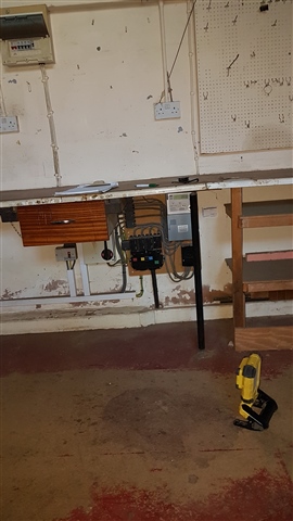

  • I have been to look at a job today,  a shop with a three phase supply and an E7 three phase meter is going to split to create two shops and a flat.
    So I need to contact WPD to request three single phase supplies for the three new premises to be supplied from the existing three phase head, both shops really need to have E7 supplies for storage heaters, the flat has a gas supply, but I'm thinking it should have an EV charge point in its parking bay.
    I can't see that this could be considered a three phase installation if the three single phase supplies are installed from the same head.
    Would there be any issues regards using open PEN protection for one or more EV charge points?
  • I'd imagine on the basis of each phase being separately metered then you have no option than to fit single phase PEN protection unless a 3phase landlords supply remains that could be utilised
  • In a perfect world it would split into 3 small 3 phase supplies perhaps 40A/phase but herein the UK we seem unable to grasp the idea that to have 3 phases in a home is OK, so suppliers, metering companies and domestic sparks are all totally unable to deal with it (and charge for it) sensibly. So it will be 3 supplies of 100A single phase and  some sort of lost PEN detector for whoever blinks and needs a charge point first.
