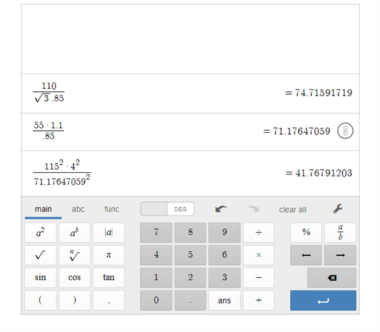

55v - 110v centre tap transformer short circuit calculations
hello
i have been trying to work out how to work short circuit calculations for 110v systems. do i use 55V with c max or do use 110v or even use a 3phase calculation. i am trying to work out if a circuit will trip on 16A c type mcb for short circuit as i am putting a rcbo in to cover the fault current.
110v 55v
0.85ohms line to line tested
4mm 2 core cable
