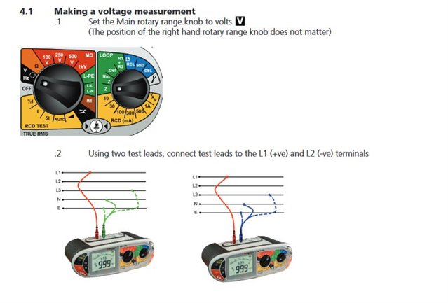

  • Megger mft 1711
  • try this
    but instead of testing L-N, the two leads go one to your test spike and the other to whatever you are checking, in this case the metal frame of the  cooker.
    No need to turn anything off.
    If you prefer you could test from MET to the spike and then ohms test to the cooker.
    Hope this helps.
    (also for a volt test your temporary spike only needs to go in about 6 inches, as you are not passing any great current.)
    Mike

  • Thanks. I'm still confused to why that would show any voltage - do you have a link to where this test is explained in detail? I tested the voltage from the spike to the metal casing of the hob and got "<10V".
    I tested the Zs from the line on the cooker plate to the earth spike and got around 500 ohms. I tested Zs normally on the cooker plate L-E and L-N both low around 0.3 ohms.
