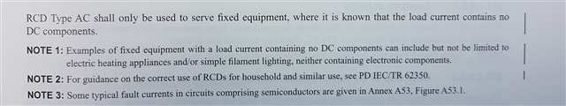

    Any way the fiagram above and other similar diagrams state that a type ac rcd can not be upstream of a type a rcd because the leakage will impact on upstream devices.
    It also implies that a type ac device can be next to a type a device because current will not flow between circuits.
    The diagram came from napit code breakers but I still can't find a regulation to reference in an iet book.
  • 722.531.3.101 goes part of the way to covering what I need but the ill informed could easily argue that my situation is compliant.
    It certainly isn't clear enough for a non electrician.
  • You would think that 536.4.1.4 should cover it. In (ii) it mentions residual currents, which presumably includes DC currents. It's solution is a type S upstream. Something not quite right there.
  • The risks from having a Type AC RCD upfront of a consumer unit full of Type A RCBOs is clear and obvious, surely there has to be an applicable Wiring Regulation?
