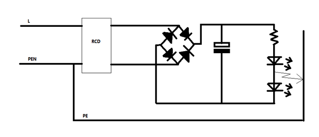

  • Just thinking aloud - say we had something with an internal d.c. supply, not galvanically isolated from the mains ('cos it's cheaper) that could under certain fault conditions send a limited current (a few 10s of mA perhaps) to PE - I've got in mind something like an LED bulkhead with an LED strip stuck to an Earthed steel dish.
    Do I have in mind (much simplified) something like:
    That of itself wouldn't be hazardous, but it seems like it could disable an AC type RCD, so loosing additional protection not just from that circuit but any other circuits that rely on the same RCD (as in split load CUs), and the first fault could persist indefinitely. It'd still need a 2nd fault for danger, but where we have additional protection we'd expect something rather better than just the old-fashioned two-faults to danger, which we're not really getting any more.
    If you think about it, even in galvanically-isolated power supplies, all you've drawn is what's up-front in a switched-mode power supply - rectifier straight onto mains, and a relatively large reservoir capacitor. MIcrowave oven HT supply may have half-wave or full-wave rectification of mains up-front, etc.

  • I am now going to reply to Andy J. The design of modern SMPS does not have a rectifier into a smoothing capacitor because the "rules" say they must achieve virtually perfect power factor. The rectifiers feed the first switch mode stage which chops up the rectifier output throughout the cycle so takes a sinusoidal current in phase with the supply. Thus good power factor. What happens after that is conventional. Small consumption appliances do not need this stage because there is a limit to the requirement in terms of power but an 800W microwave with a SMPS would have to comply. Essentially we have a load which must take equal current from L and N whatever happens to it's output, the mains cannot have a DC component! A fault to Earth would simply cause more mains consumption, not DC! The Earth wire might carry DC, but that does not flow as DC through the RCD, simply in the Earth-supply TX N loop, which is not seen by the RCD! Interesting, try sketching a circuit diagram, there is a double wound transformer in the way in the appliance. Until someone makes a complex SMPS without a transformer there is basically nothing to worry about, as long as it is not possible to contact the DC output and the class 2 transformer is not faulty, even if it does operate at 100 kHz or so. You do need to realise that an Iphone charger or similar has this class2 transformer, but it is very small due to the high frequency of operation.
