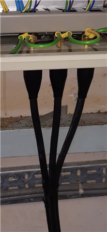

Earthing or bonding ?
I see it a lot where the SWA isn’t serving as a protective conductor which I know it must still be earthed at one end due to being an exposed conductive part. My question is if multiple SWAs are all earthed at the supply end and meet again at a bit of equipment if we then connect all the SWAs together locally is this still classed as earthing even though they are already earthed at the supply?

  • The S.W.A. gland at the end of the cable can not become live, as it is earthed. It is connected to the earthed armouring. The origin of the cable must be correctly glanded and earthed. Also it is not exposed as it is covered with an insulating shroud.
    The gland is a component part of the armouring which is a circuit protective conductor combination. 543.2.1 (v).
    I agree with this sparks' comment.....
    nrg: The use of a third core as a cpc in SWA cable isn't an alternative to using the SWA as the earth; it's an additional measure, because the SWA would have to be connected to earth (at the supply end at least) anyway, so that the cable is protected from mechanical damage.
