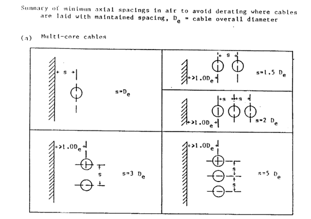

Ive inherited a job, where we have a large LV Switchpanel sitting ontop of an open concrete trough.
I have approximately 18No. 95mm/120mmm SWA 4 Core cables feeding panel boards exiting into the trough below from the switchpanel for about 3 meters before it exits the trough and below the building but still above ground level (the buildings on stilts) onto a tray.
I am just struggling to find the correct de-rating factor in BS7671, 117-120 doesn't seem to quite fit the bill, but 119 seems to be the closest. But cant see it working, especially as it recommends 75mm apart, witch is 18 x 75mm = 1350mm and a maximum of 6 cables

  • i assume you know you can get cables packed rather closer sideways before you need to consider the neighbours, than you can vertically - as vertically cables are heated by the ones below.  it may not be mechanically practical, but if you can lay the cables side by side or even on a rack that is canted at an angle they will cool better than parallel to the trench wall.
    you will need some vertical stacking but if it can be offset so that they are not exacttly one below the other it will cool better.
    In reality nothing beats getting a bit of airflow, so do not put any cable  fully loaded  too close to the lid, ideally below the highest point that air can escape. The simple model assumes the wall is very high and airflow at the top is essentially unobstructed here it sounds like neither is true.
    If the trench is above ground do you need to consider the heating effect of direct sunlight ?  This can easily add 10-20C to the temperature compared to underground on a hot summers day.
    Mike
    PS that illustration  is from a paper that in turn refers to the ERA test results. in your case De is 40mm or 50mm approx. and presumably loading of something like 300/400 A per core top whack..

  • well 60% of full current is (I squared R) 0.6* 0.6 of the heating so  about 0.36,  and  temp rise drops pro-rata more or less with dissipation.  You can have almost as many cables as you like horizontally spaced by two diameters or more, adding more runs to the edges does not really affect the middle ones. Not true vertically where the poor so and so at the top gets all the heat of all the cables below it so adding more keeps making it worse.
    Grid/ mesh floor /lid is good so is wider trench. Less clear on your insulated earth mat idea, that I may have mis understood
