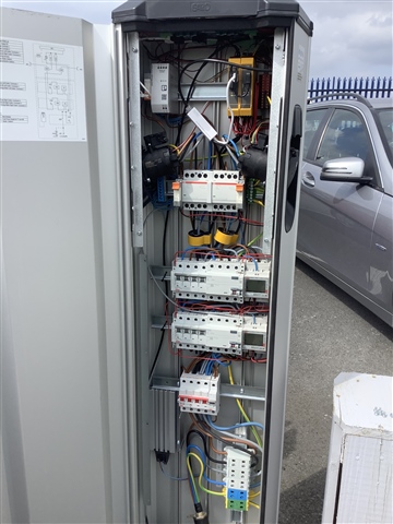

  • One of 10 22Kw twin units we installed from Garo. RCDs individually protect each socket. 300mA type A S-type RCD as main incomes in the DB supplying this pillar.
    As far as I can see on the domestic side, the EVSE circuit is normally bunged in with other circuits in a split load board so RCD is not individual to the EVSE.
