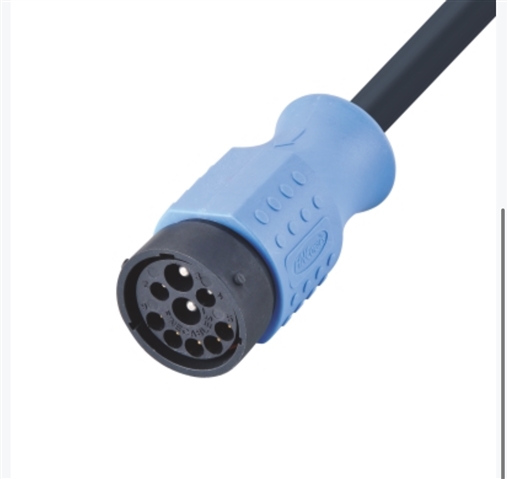

  • Hi,
    I’m not suggesting that at all, however there are tones of products out there that combine data and power into hybrid cables, with many of these featuring connectors that have specialist pin-outs that cater for power and data. An example is here:
    These are fitted by lighting manufactures to products which combine power and DMX into the same cable. This then lands into a junction box, where you then terminate your power and data. They also provide pre-made jumper cables to link products together.
    The cables and the luminaires and equally and jointly as a finished product, CE certified and sold for fixed installations.
    An installer would follow manufactures instructions to install this equipment.

    Are you saying that EV Ultra cable is therefore not allowed? The product itself is CE certified and it’s being installed everywhere.
    Well, perhaps not allowed for cabling installations to BS EN 50174-2 (indoor and within structures cabling), especially where it comes out of the ground?
