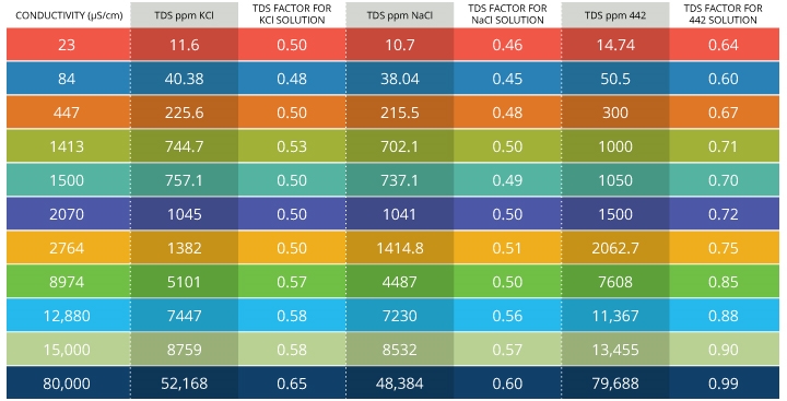

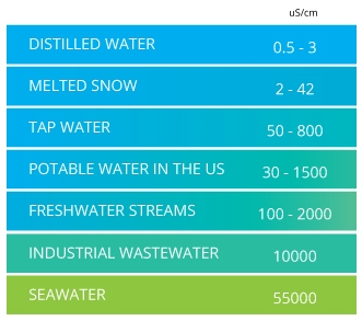

  • The conductivity of a municipal swimming pool water is monitored and reported in units of 'total dissolved solids' although the exact choice of "action limit" when the water needs changing or filter need cleaning depends on things like chlorination levels.
    Typically a TDS level of a few thousand PPM for a swimming pool. (some hundreds of ohms on a cm cube ) Compared to a few hundred for tap water (some k ohms per cm cube.).
    Converting to a single % 'TDS' total dissolved solids from measuring conductivity is a bit of a con, as the different ions do not have quite the same mobility in a given electric field, but close enough for some generalizations to within a factor of 2. That may sound terrible, but as the salt concentration varies by factors of ten and is about as uniform as wind-speed in places where water flows and mixes, it is often good enough.
    (1uS/cm is 1 megohm.cm and 100uS/cm is 10k.cm 1000uS.cm 1k ohm.cm)
    These are American figures, and their idea of clean tap water is not the same as ours, but it is quite similar.
    In the table  below "442 solution" contain the following salts diluted in pure water: 40% sodium bicarbonate, 40% sodium sulphate and 20% sodium chloride. These represent the main conductive ions that are in typical surface and ground water. A purely sodium chloride solution is probably more representative of brackish salt marshes or sea water.
    Note the dramatic effect of seawater -  less than 20 ohms across a 1cm cube compared to k ohms.
