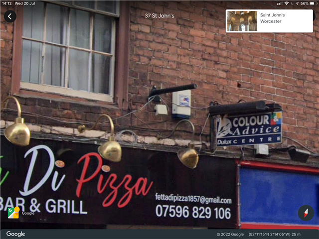

  • It’s a few years since I converted a fluorescent fitting to LED, the last one I did was over a Dulux Paint sign outside a former DIY shop that had become an Indian Restaurant.
    As it is a Conservation area it seemed easier to revamp the existing illuminated sign than apply for permission for a new one, but no one changed the actual sign.
    Once the starter is replaced there’s nothing to control the current if someone swaps a fluorescent tube back into the fitting, so the starter really needs swapping for a fuse, which can be a fused dummy starter or a fuse in a holder within the fitting, if you can get a suitable one.
  • ah is that why the Indian food is so colourful?  Dulux paint....
