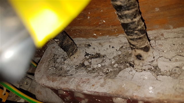

Has this any failings do you think? The door can be replaced.
There's no stopping me now.
  • I love the 2-colour warning notice.
    I don't know which is the "MET", but the one below the head has too many cables for my liking. Whatever happened to the idea of the double screw terminal?
    All those earth wires are connected to the water pipe clamp on the lead sheath of the incoming cable.

    I did wonder if it’s possible for the pitch filling to have been attacked by woodworm.
  • No I think not. It is too sticky and chewy for wood boring insects.
    Z.
  • The backboard would seem a preferable choice.
  • I think personally I'd pass on eating either. But there are quite possible bubbles or even quite long tunnels where either air or moisture was entrained when the tar was originally poured that leave it slightly porous or indeed some lighter hydrocarbons oils or paraffins  were in the mix that have evaporated. - cold applied roofing tar  - the stuff dissolved in naptha, often sets slightly bubbly for the same reason. Tar from the gas works did not always have a well defined make-up, it was just cheap waterproofing and long lasting. Before modern plastics there really were not so many choices
  • The mice ate the caps and nozzles on my cans of WD40 and are quite partial to PVC insulation, so I suppose it’s a matter of personal choice.
    The CC on the head presumably is Cardiff Corporation so puts it pre-1948, so between 74 to 128 years old.
    I would inclined to go towards 128 years old rather than later.
