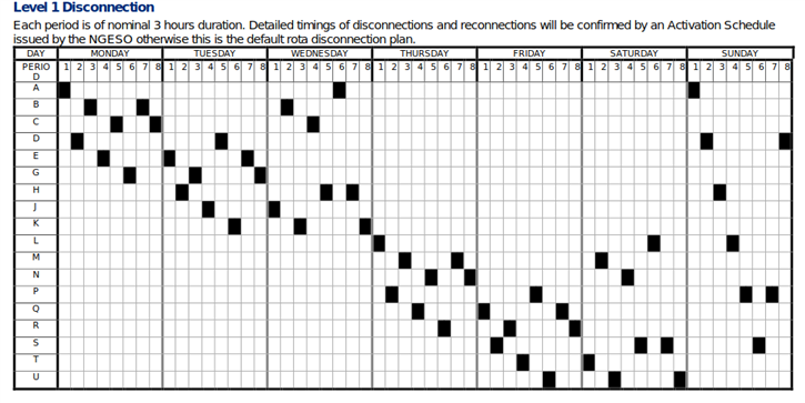

  • well what to they do in a power cut ? If it is really that important expect battery back up or redundant supplies /back-up gensets etc.
    Note that in another post we are discussing the likelihood of rota power cuts this winter. If this happens, then for everyone involved the electricity supply will be turned off (in blocks) for pre-announced multiples of 3 hours at a time, depending on the shortage of electricity. This could be affected by the weather, the time of day and the demand for electricity. At the lowest level of emergency, you could expect to be without electricity for just three slots (9 hours) spread over a week. However, if there is a severe shortage of electricity, all users may be without supply for several slots each week.
    Edit flick to the back of the emergancy code to see the degrees from 1-18 of severity in all its black and white rectangular glory.
    level 1 is modest

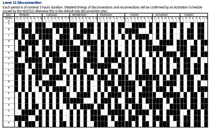

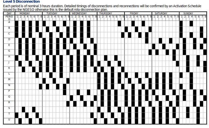

    by level 5 its is off a lot of the time
    and the upper levels are off more than on - this is level 11
    Mike.
