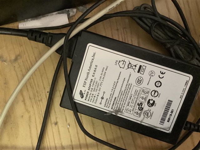

  • I was asked to investigate a low value of IR in a large, rambling GP complex. An EICR conducted by others had an unsatisfactory designation because the value recorded for a number of circuits was 0.16Mohms for which the contractor awarded a FI code. The surgery manager needed the report returned to satisfactory for statutory purposes.
    Three-phase installation with several 16-way TPN boards all with 3pole isolators with circuits neatly installed using single core cables in metal trunking/conduit. Hundreds of items of equipment connected. My view was that it was madness to conduct IR tests in the first place and expect a meaningful outcome.
    My rate for Saturday isn’t eye watering but it ain’t cheap either. I agreed same with manager and insisted that an electrician was on hand to assist. Real pain to disconnect the equipment and had to remove circuit neutrals but eventually tracked it down to these fellas. Several on individual circuits pulled the IR down. At 250v the individual reading was around 0.5Mohms.
    So if the guys doing the EICRs continue to do bonker things, I reckon there is a few quid to be made sorting the nonsense that is generated. I wonder how much these poorly conducted EICRs are costing clients across the U.K.!
