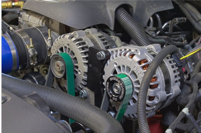

  • This is probably not a good idea, the battery is far too small for it to be more than an emergency cooker. A better choice would be a nice quiet small generator of 2kVA or so, Honda make some nice ones. The best question is why a microwave, normal propane cookers are probably a much better bargain overall, unless you are addicted to ready meals. Do they have a fridge too, presumably gas? My friend has a (large) RV but this has 1000Ah of backup batteries and a generator (key start diesel) for proper power, its very comfortable including the aircon! Charging this battery will also be a problem, in parallel with the vehicle battery is not a good idea, both being flat is not a good problem to have, and diode split charging will need a fair bit of work and an unusual alternator to deal with the volt drop and dual sensing.

  • Often a DC-DC converter yes., In the old days the leisure battery was just connected across the ignition circut to charge it but that often confuses modern engine management systems as they then think that the main traction battery isn't charging as it should....
    Not sure about motorcaravans but with towing caravans there's normally a 'habitation relay' too - that switches off all the caravan's circuits when the ignition is on (but allows the leisure battery to charge from the traction battery/alternator and the fridge to run on 12V from the traction system) - the idea being that stuff in the caravan can't then interferre with the engine operation.
  • at the shallow end, rather than dual alternators
    and or diode switching diode example, a  simple relay that parallels the auxiliary battery to the cranking one when the latter is at more than 13.5v i.e. pretty much  charged is common. However a single car grade alternator may struggle with a flat battery and the loads of a dark winters night,  example relay. It also confuses those  stop and go systems that cut the engine at traffic lights etc. Fine for doubling up 2 similar batteries but not anything seriously heavily loaded.
