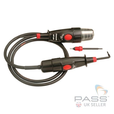

  • My Schneider Volt stick sometimes gives false positives where supposedly dead cables run parallel to live cables where the live cable(s) induces a current in the supposedly dead cables.
    A test lamp is a good way to double check.
    Drummond MTL1000 Spare Bulb - Martindale Electric (martindale-electric.co.uk)
    Z.
