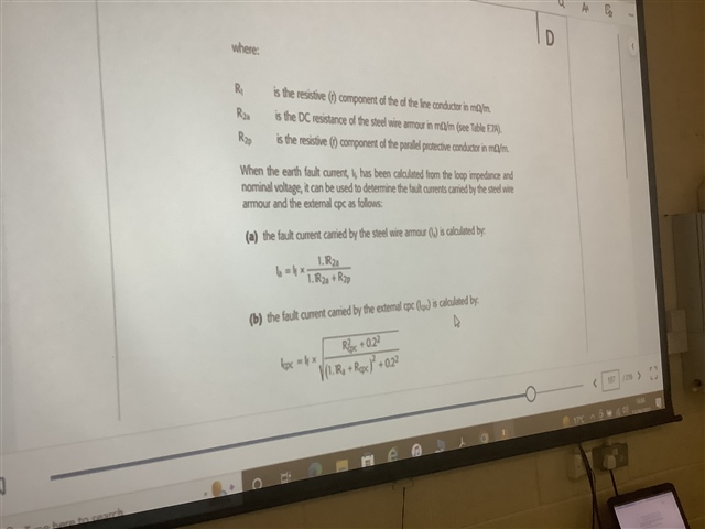

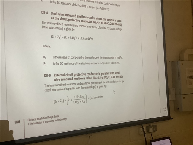

    If armoured cable is used, even relatively small csa, the armour csa is usually > 16 sq mm, and therefore the relevant method in PD CLC/TR 50480 should be used due to the reactance of the armour, or the armour/external cpc combination. Note that often - but especially if the cable is buried - the armour (perhaps in parallel with a copper conductor) has to be capable of acting as a cpc, whether you use it downstream or not, because a fault to it is possible, and it's often connected to exposed-conductive-parts.
    The 5th Edition (2022) of the IET Electrical Installation Design Guide, and the 9th Edition of Guidance Note 6 Protection Against Overcurrent, discuss the relevant calculation methods according to PD CLC/TR 50480.
  • Just doing these on a 2396 class today. The two currents are not in phase so do not add arithmetically
